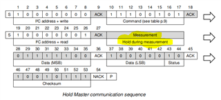

    I am using the HTU21D sensor.
    I was download the twi_scanner example to scan the HTU21D sensor's slave address. the others sensors can be sanned.But the HTU21D can't be scanned.
    I  used the slave address 0x80 > > 1 (the address is 0x80 from HTU21D datasheet), the amazing things was happened. i can used (write and read) the user register. But i  can't use (read) the   Temperature and  Humidity register.
    1.   I want to know how to add the delay function after sent/written the read address.
    2.  I will  be happy to get your advice.
  • We need a scope from a digital analyzer in order to know what's going on.
    The holding/delay seems to be controlled by the slave, not the master.
    I use oscilloscope, at first there is level conversion, then there is no.
    I used analog I2c could  add the delay function after sent/written the read address by the master.
    Below is the main.c file

    Below is the log file
    <info> app: Value: 0x2 .
    <error> app: ERROR 17 [NRF_ERROR_BUSY] at ..\..\..\main.c:110
    PC at: 0x000021A5
    <error> app: End of error report
    I sincerely look forward to your reply. thanks
  • NRF_ERROR_BUSY means that the TWI peripheral is still in a transaction and that you need to retry at a later point.
     I do not know what that means, can you share a scope of the TWI lines?
  • I used an oscilloscope to grab the waveform of the SCL line, and there was no waveform change after the application reported an NRF_ERROR_BUSY error. I debug found that the applocation is stop at while (m_xfer_done == false);
    Sorry, I didn't understand what that meant
  • Can you share a scope of the SDA and SCL lines?
     It means that the driver is busy with the last transaction and that you need to wait until the last transaction has completed until you can issue another one.
