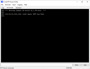

I just trying log via Segger RTT viewer, followed the the same procedure as that of serial_lte_modem sample in my new project and could not see logs showing in the viewer.
NOTE: The RTT logging works fine with serial_lte_modem sample
prj.config
# General config
CONFIG_ASSERT=y
CONFIG_LOG=y
CONFIG_LOG_DEFAULT_LEVEL=3
CONFIG_STACK_SENTINEL=y
CONFIG_CP_LOG_LEVEL_INF=y
# Segger RTT
CONFIG_USE_SEGGER_RTT=y
CONFIG_RTT_CONSOLE=y
CONFIG_UART_CONSOLE=n
CONFIG_LOG_BACKEND_RTT=y
CONFIG_LOG_BACKEND_UART=n
Kconfig
source "Kconfig.zephyr"
menu "TCP/IP Server client"
module = CP
module-str = server client
source "${ZEPHYR_BASE}/subsys/logging/Kconfig.template.log_config"
endmenu
main.c
#include <logging/log.h>
LOG_MODULE_REGISTER(main, CONFIG_CP_LOG_LEVEL);
    LOG_INF("RTT Log Test\n");
Is there anything else i am missing here?
