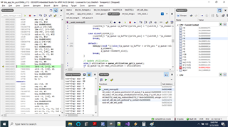

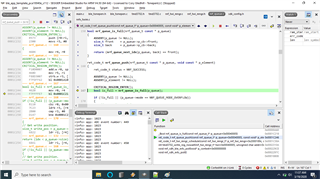

Crash on nrf_queue_push() when using the TWI MNGR
I'm using the TWI_MNGR to schedule a transfer. I have copied the nrf_twi_mngr_perform() function to a function called nrf_twi_mngr_schedule() which does everything except waiting for the transaction to complete. I changed internal_transaction to a static variable so that the schedule transaction still has access to it after my modified perform() function returns. Please look at these functions:
ble_tonepen.c
        void tonepen_char_on_write()
        nrf_twi_mngr_sched_nowait() ***this is modified version of perform()

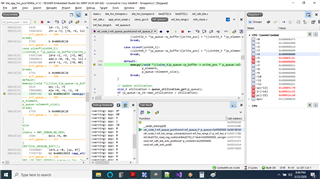

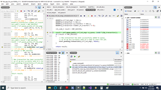

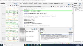

The program crashes on nrf_queue_is_full() so I believe the problem is that the queue is full or possibly not initialized properly. I don't see any define in sdk_config about the queue size. I have...
NRF_QUEUE_ENABLED 1

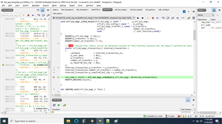

void nrf_twi_mngr_sched_nowait(nrf_twi_mngr_t const *          p_nrf_twi_mngr,
                                nrf_drv_twi_config_t const *    p_config,
                                nrf_twi_mngr_transfer_t const * p_transfers,
                                uint8_t                         number_of_transfers,
                                void                            (* user_function)(void))
    ASSERT(p_nrf_twi_mngr != NULL);
    ASSERT(p_transfers != NULL);
    ASSERT(number_of_transfers != 0);
    // TODO: should this static struct be declared outsite of this function because the TWI doesn't perform at once.
    static nrf_twi_mngr_transaction_t internal_transaction =
        .callback            = internal_transaction_cb,
        .p_user_data         = NULL,
        .p_transfers         = NULL,
        .number_of_transfers = 0,
        .p_required_twi_cfg  = NULL
    internal_transaction.p_transfers = p_transfers;
    internal_transaction.number_of_transfers = number_of_transfers;
    internal_transaction.p_required_twi_cfg = p_config;
    ret_code_t result = nrf_twi_mngr_schedule(p_nrf_twi_mngr, &internal_transaction);
    VERIFY_SUCCESS(result);

  • Because I couldn't get TWI_MGR working I have implemented the twi_sensor_pca10040 example, migrating it to NRF52810 hardware. I'm still having trouble getting TWI working with my TMD3702 light sensor. After I call nrf_drv_twi_tx() the program gets stuck on in the (m_xfer_done==false) loop.
    What is strange is that when I was using TWI_MGR I could call nrf_twi_mngr_perform() successfully but not nrf_twi_mngr_schedule(). As shown in my post above I believe that has to do with the nrf_queue. I noticed a something about a workaround related to TWI. Could that be related?
  • I'm still having a problem with nrf_queue when using the TWI_MGR. I could use any help I can get at this point. Here are the screen caps of the problem I'm dealing with. These are different levels of the call stack all on the same program failure. Is there a setting in sdk_config.h to adjust the queue?
  • Sorry for a really late response.
    issuing a TWI transaction inside softdevice BLE event handler seems to be not a good idea. Could cause bottlenecks.
    I would recommend you to push the TWI transaction onto the app_scheduler instead of running it in the event handler.
