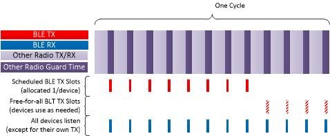

Our device using nRF52840 is running an external (non-BT) radio most of the time. We need to send and receive data In between operations of this other radio.  At any given time, there will be one sender and multiple receivers.  Since there will be no BLE connection or interaction, this is essentially a beacon operation except for the scheduling.  We are trying to understand if it is possible to manually send and receive without running a BLE schedule and without any interaction between sender and receiver.

The overall schedule will be something like
Receive-only devices:
  1. Receive other radio
  2. Receive BLE (20-40ms interval)
  3. (repeat steps 1 & 2 indefinitely)
Receive/Transmit devices:
  3. (repeat steps 1 & 2 N times)
  4. Transmit other radio
  5. Transmit BLE
  6. (repeat steps 1 - 5 indefinitely)

    first,both radios are controlled by the 52840 so we can easily schedule both.  the question was more about sending BLE packets on demand.
    What I meant above is: although we have a periodic schedule and a specific 20ms window allocated to each device within that schedule, we cannot simply do a periodic beacon (even if we could synchronize).  This is because in certain circumstances the customer wants us to re-broadcast in unused slots to increase the chance of reception.
    Having said all that, being able to transmit and receive on demand will meet all our needs.

    Could you possibly provide an overview of the entire radio period, which indications of how long each time-slot is, and how many there are? I am having a hard time understanding why setting up a broadcaster, such as in the beacon example, is not feasible for your application.
    Please see attached drawing, this is the best I can do without violating NDA.  The "problem" slots are the striped ones that he devices may use asynchronously based on events beyond this discussion.
     Aha, I see what you mean. Well, I suppose you could attempt to start an advertising at the beginning of the slot and stop it at the end - could you attempt this, and let me know if it suits your application?
