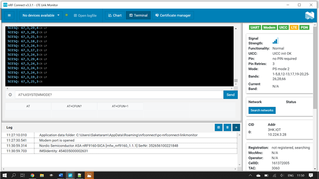

  • Hi Hakon,
    I just received the sim cards from Three in Hong Kong, one of the 2 providers of NB-IoT service in Hong Kong. The cards were activated and I followed your advice, by switching to LTE-CatNB1. I could  go further:
    *** Booting Zephyr OS build v2.1.0-ncs1-snapshot1  ***
    The AT host sample started
    AT%XSYSTEMMODE?
    %XSYSTEMMODE: 1,0,0,0
    OK
    AT+CFUN=4
    OK
    AT%XSYSTEMMODE=0,1,1,0
    OK
    AT%XSYSTEMMODE?
    %XSYSTEMMODE: 0,1,1,0
    OK
    AT+CFUN=1
    OK
    AT+CFUN?
    +CFUN: 1
    OK
    AT+CGSN=1
    +CGSN: "352656100221848"
    OK
    AT+CGMI
    Nordic Semiconductor ASA
    OK
    AT+CGMM
    nRF9160-SICA
    OK
    AT+CGMR
    mfw_nrf9160_1.1.1
    OK
    AT+CEMODE?
    +CEMODE: 0
    OK
    AT%XCBAND=?
    %XCBAND: (1,2,3,4,5,8,12,13,17,19,20,25,26,28,66)
    OK
    AT+CMEE?
    +CMEE: 0
    OK
    AT+CMEE=1
    OK
    AT+CNEC?
    +CNEC: 0
    OK
    AT+CNEC=24
    OK
    AT+CGEREP?
    +CGEREP: 0,0
    OK
    AT+CGDCONT?
    OK
    AT+CGACT?
    OK
    AT+CGEREP=1
    OK
    AT+CIND=1,1,1
    OK
    AT+CEREG=2
    OK
    AT+CEREG?
    +CEREG: 2,4,"FFFE","FFFFFFFF",9
    OK
    AT%CESQ=1
    OK
    AT+CESQ
    +CESQ: 99,99,255,255,255,255
    OK
    AT%XSIM=1
    OK
    AT%XSIM?
    %XSIM: 1
    OK
    AT+CPIN?
    +CPIN: READY
    OK
    AT+CPINR="SIM PIN"
    +CPINR: "SIM PIN",3
    OK
    AT+CIMI
    454035000002631
    OK
    %CESQ: 72,3,25,3
    +CEREG: 2,"0BF4","099E5765",9
    +CGEV: ME PDN ACT 0,0
    AT+CGDCONT?
    +CNEC_ESM: 50,0
    +CEREG: 1,"0BF4","099E5765",9
    +CIND: "service",1
    +CGDCONT: 0,"IP","3HK.IOT","10.224.3.28",0,0
    OK
    AT+CGACT?
    +CGACT: 0,1
    OK
    %CESQ: 72,3,17,2
    %CESQ: 72,3,24,3
    %CESQ: 72,3,17,2
    %CESQ: 72,3,24,3
    %CESQ: 67,3,24,3
    %CESQ: 67,3,29,4

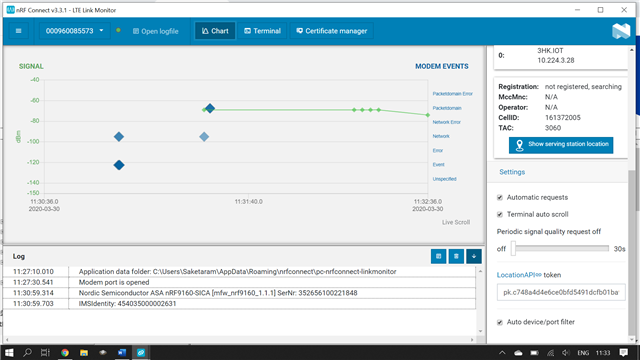

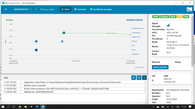

    The screen shows:
    But still, the "LTE" indicator on the top right of the screen is blinking Yellow/Red continuously, even after 10 minutes.
    Anything missing in this configuration?
    Thanks in advance.
  • The "LTE" indicator is unrealiable and doesn't really show whether you're connected or not. The device seems to be properly connected.
  • Hi Hakon,
    After rebooting and setting up again AT%XSYSTEMMODE=0,1,1,2
    it worked:
    Thanks for the setup information!
