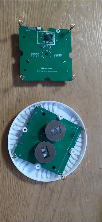

  • thanks for your reply.
    our antenna switching ic is "SKY13322-375LF",whitch's switching time is 60ns.
    We got 96 data for each ant.
    1-16 ignored(may be changed with the switch)
    17-80 used for compute average phase
    81-96 ignored(may be changed with the switch)

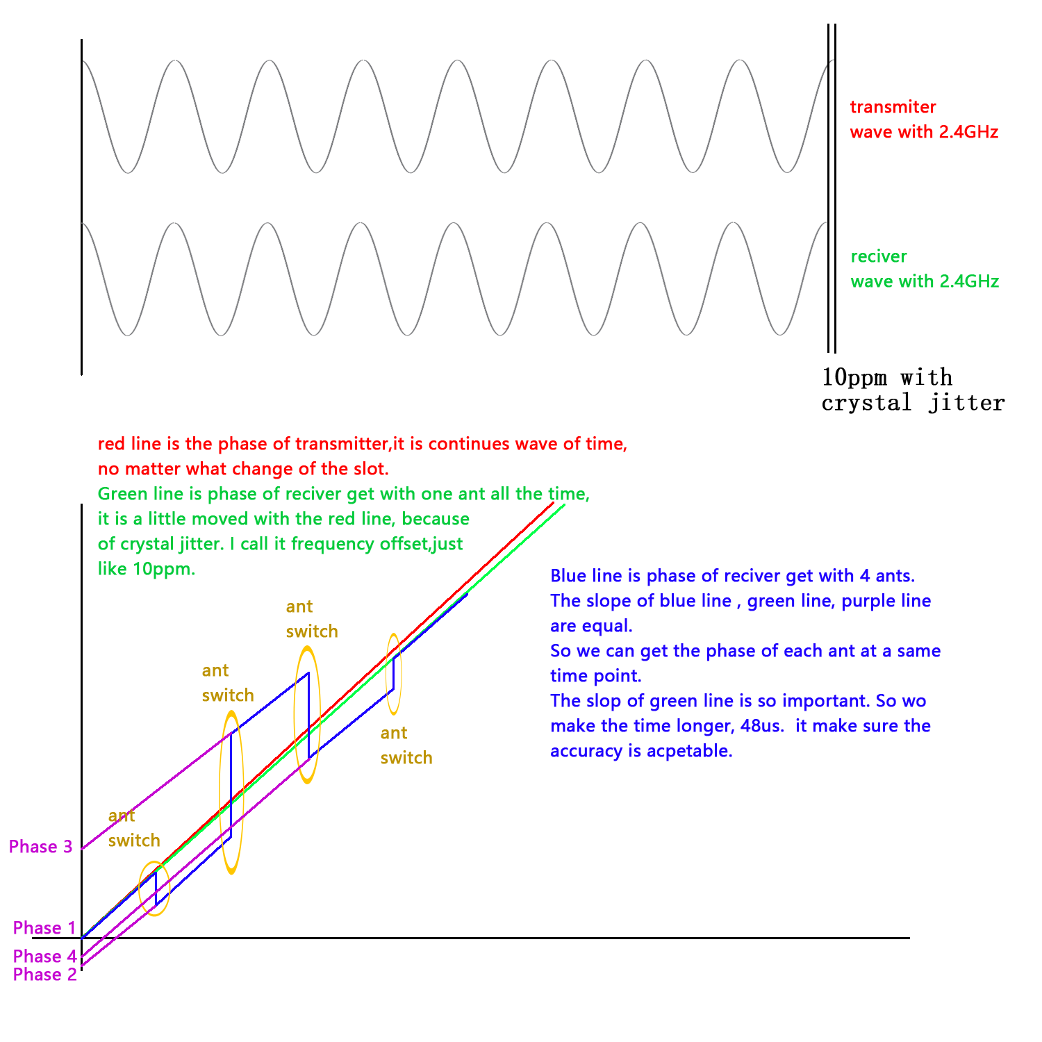

    How we compute phase
    1:we have 4 ants all;
    2:we get 1st ant and 5th ant the same one
    3:comput frequency offset beteen receiver and transmitter with 1sth and 5th ant(whitch is same ant)
    (longer slot -> more crystal jitter influence -> lower accuracy) may resoved?
    frequency offset <0.2%wave change,like 11.373,11.372,11.374,11.370
    If frequency offset is 0, we will get num like, 12.500 beteen each data.
    4:use 17-80 datas of each ant compute average phase
    5:compute phase back to the time of first ant.
    example
    1th average phase:221
    5th average phase:166
    will get the change beteen each data is 11.373(frequency offset=22.54kHz )
    2nd average phase:296 --> 9(phase of 2nd at 1st ant time)
    (296-(11.373*96))=-795
    -795+402*2 = 9
    3rd average phase:249 -->76(phase of 3rd at 1st ant time)
    4th average phase:271 -->-190(phase of 4th at 1st ant time)
    Is there any mistake?

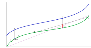

    it's better to look at the plot, hard to say exactly where slots are changed. In theory you have two samples for reference period then continuous set of 0.125us samples after 1us gap.
    as a variant, but
    what I mean - the distance between points that you compare should be as short as possible, a jitter is really noticeable. You have 12us slots, it's too long. Of course you can average between multiple periods, but I see no reason for adding jitter error if you can work with shorter slots.
    Maybe I didn't understand clearly, but you should apply frequency offset correction to each sample before calculating average phase.
  • I draw a pic, wish you can understand what i mean.
