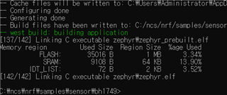

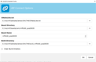

I tried to build this example by command window and SES.
When i'm done by command window, Below is my result.
Alternatively, if this build by SES, the result is different.

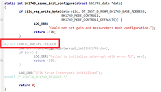

I checked why output size is different.
I figured out that  CONFIG_BH1749_TRIGGER is not activated on SES like below.
Does anyone know why this kinds of thing happnens?
