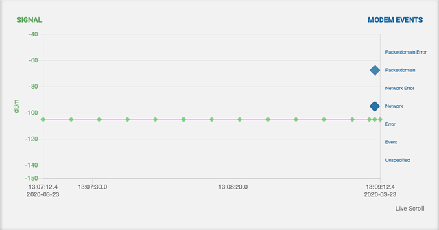

However, if I use the AT Client App, I see that the device should have a stable connection at -105dBm or CESQ 36:
I am using NB-IoT on the Vodafone network, I have edited the sample's prj.conf to include APN and Modem configurations for this conection:
