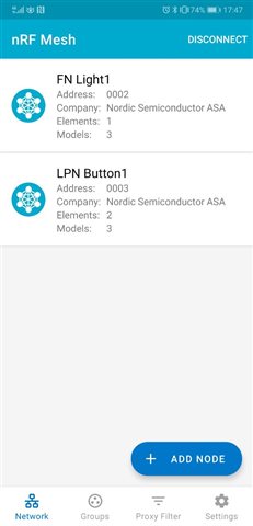

I am trying to send messages from my gateway, which has UART and __LOG enabled, to a specific LPN address (0003).
 So I want to send messages from my FN Light1 (0002) to LPN Button1 (0003).
I am trying to change publication address, and I think this works:
