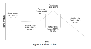

Our clients are developing Pick to Light System with 52840.
And they'd like to know why the reflow time is such long (60s-90s),it's described in nAn-40:
I believe it is must already well tested by Nordic lab or factory to confirm the reliability,
but is there any other particularly reason to suggest our client about such a long time setting?
