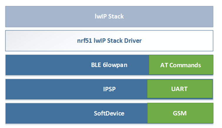

I want to communicate with lwm2m server using gsm module and nrf52832 as lwm2m client. i installed lwm2m demo server over linux machine.
Hi Abhishek,
We have some question regarding your setup.
- Which protocol is on the UART communication between the GSM module and the nRF52 ? Is it AT commands ?
- Where should the IP stack implemented ? Is it on the GSM module or it's on the nRF52 ?
Hi hung bui,
-for first yes i am tried to use AT commands between GSM module and nRF52 by using app_uart.h.
- everithing is in nRF52 code like ip stack , server uri , lwm2m setup object callback and declaration.
Hi Abhishek,
The current implementation in our IoT SDK doesn't have the IP stack running on the nRF52. It's on the gateway as shown here.
I assume you don't use BLE for this communication at all ?
I got a suggestion from our developer with the following diagram:
If you don't use BLE 6LowPAN then only the green part is needed.
We suggest you to implement the IP stack driver with network interface, for example lwIP in our older IoT SDK: https://infocenter.nordicsemi.com/topic/com.nordic.infocenter.iotsdk.v0.9.0/iot_sdk_user_guides_lwip_stack.html?cp=7_4_4_12
The network interface here would be useful: https://github.com/ARMmbed/mbed-os/tree/master/features/lwipstack
Please be aware that this is not something we can support and make an example for you. And you would need to implement based on what we have. And we believe there should be someone else already implemented something similar.
For example: https://github.com/ARMmbed/mbed-os-example-cellular
