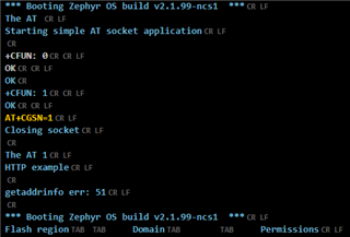

i work on nrf9160 dk
I would like to know if it is possible to use an AT firmware to be able to easily switch to LTE-M, NB-IOT, send sms, switch off the modem etc.... and also to make http post as on the example "http sample" which works very well.
I tried the firmware "simple_at" which works well too but by combining the two, nothing works anymore.

    Can you provide some more information regarding what version of NCS and modem FW your are running?
    Thank you!
    Øyvind
    My working environment is:
    NCS folder tag: Master
    Modem FW: 1.1.1
    test sample code:\ncs\nrf\samples\nrf9160\at_client
    thank you
    Max
  • Thanks for providing the information.
    getaddrinfo err: 51, seems that you do not have a network:
    // From zephyr\lib\libc\minimal\include\errno.h
    #define ENETUNREACH 51  /* Network is unreachable */
    What does your prj.conf look like?

    I'm trying to make a code that:
    1- Modem OFF
    2- Modem ON + http post
    3-Modem OFF
    I make sure that CONFIG_LTE_LINK_CONTROL = y is not present in the prj.conf file to be able to turn ON and OFF the modem with AT + CFUN = 4/1
    But I have the impression that the problem comes from CFUN = 4

    but same result if CONFIG_LTE_LINK_CONTROL = y present and start at command with CFUN=4
    or CONFIG_LTE_LINK_CONTROL = y non present and start at command with CFUN=1 etc..
    (11:44:51.028) ***** Booting Zephyr OS build v2.0.99-ncs1-rc1-11-g9be97c63368a *****
    (11:44:54.524) Starting simple AT socket application
    (11:44:54.534) <CR>OK<CR>
    (11:44:55.965) OK<CR>
    (11:44:55.965) +CFUN: 4<CR>
    (11:44:55.990) OK<CR>
    (11:44:55.990) +CFUN: 1<CR>
    (11:44:56.025) OK<CR>
    (11:44:56.025) +CEREG: 0,0,"61A0","01189806",7<CR>
    (11:44:56.025) Closing socket
    (11:44:56.025) <CR>HTTP example
    (11:44:56.025) <CR>getaddrinfo err: 51
    Kind regards
  • Hi Max,
    From what I see, you're not waiting for the network connection. Between each switch of  LTE-M and NB-IoT, you need to verify the connection. In NCS this is handled in nrf\lib\lte_link_control\lte_lc.c, more specific the w_lte_lc_connect(). Have a look at the do{}while loop.
    Øyvind
