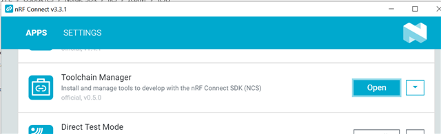

  • I managed to make this work, I did the following:
    • Installed ncs v1.2.0. Check out our newly released app Toolchain Manager, which simplifies the process of installing ncs
    • Opened Git Bash
