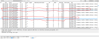

We are using NRF52840 Dk board to transfer the data at 10ms through Bluetooth which is central and peripheral  as other cc250moda controller  Bluetooth. Our objective is to send the data of 8 bytes at  10ms from the NRF52840 Bluetooth to other Bluetooth. We are able to send the data from NRF52840 Bluetooth of 8 bytes at 30ms,50ms,100ms,500 ms to other controller Bluetooth correctly which means at every 50ms  we are sending 8  of bytes data which is receiving  8 bytes of data at every 50ms in the receiving controller Bluetooth. The problem here is when we are sending the  8 bytes of data at 10ms from NRF52840  Bluetooth to  receiving Bluetooth it should read  8 bytes of data at 10ms but here the problem is it is reading as 8 bytes, 16 bytes ,24 bytes ,0 bytes ,0 bytes, 24 bytes,16 bytes, 0 bytes, 0 bytes  as such at every 10 ms.Can you please tell me what is the problem . How to resolve the issue.
    I am not sure I understand exactly what you issue is here, other than the BLE communication not behaving as wanted.
    Could you detail the issue some more, what parameter are you changing to differentiate between the different sending intervals? Could you share that snippet of your code?
    Karl
  • Thanks for the reply.
    I am here by attaching the code here at 10 ms.

    I am  here by attaching the captured sniff data between the central and peripheral.captured_logdata.pcapngcaptured_log1data.pcapng
  • Hello again,
    Those logs were much better, thank you.
    When viewing the logs, this seems exactly as it should be to me.
    The delta time for each transmission is ~10 ms for each transmission. From this, we can now be sure that you are in fact completing your data transmission (the 0x11, 0x12, 0x15 .. data) every 10 ms.
    If you take a look at packet number 531 particularly, that is when the central initiates the connection - with 8 as connection interval, which translates to 10 ms (8 * 1.25 ms).
    Seeing this, in combination with the printed UART log you shared earlier(where the data is not being processed right away after being received. So, that leads us to examining what the peripheral spends its time doing.
    When does the data handling happen? Could it be that your device is over encumbered, and thus not always finish its processing of the received data in time, before a new packet is received?
    It could also be that the UART logging itself is what pushes the peripheral to miss its processing windows - are you using deferred logging?
    Karl
    In the peripheral side the there is an scheduler function which reads the data at every 10ms. I am using termite application to log the data from the controller.
    But in the captured_log1data i have noticed that one point of time the master has not connected to slave  but the data is sending.I am here by attaching the log file .
    please give me the solution.
    Could you share some code or elaborate more on the scheduler function you use to read data ever 10 ms? It could be that this scheduler does not work as intended.
    The first highlighted section might be caused by the peripheral not acknowledging the reception of the packet sent from the central device. This causes the central to resend the packet.
    It might also be due to that the sniffer might receive packets that is lost or corrupted to the central/peripheral device - and vice verse. The first highlighted section of the screenshot you have shared might be showing this. That the sniffer lost a packet that the central/peripheral might still have received.
    The frequency of loss and packet corruption depends heavily on the environment in which the devices are working.
    What is interesting is the transmission starting on packet number 1209... I must have missed this exchange when reading the log earlier. What might be happening is that the central attempts to start a transfer, that is not acknowledged by the slave. This causes the central to have to wait until the next connection interval to re-transmit the non-acknowledged packet. Since your program schedules new data to be sent every 10 ms, a new packet will be placed in the TX buffer before the previous is retransmitted. This leads to the transmission exchanges we are seeing at packet 1209 - the master suddenly has more than one packet to transmitt at once, since the previous one was never acknowledged.
    The re-transmission feature also ensures that no data is lost, even though it will arrive in the next connection interval. Note also how all the extra data is fitted into the next connection interval, without causing any sort of delay.
    So, In essence; you are ensured that all the data will be transmitted over the BLE connection, but some data might arrive in the next connection interval, if the first transmission attempt is never acknowledged by the peripheral.
    This is probably the cause of the logger "stutter" you've seen in your log. :)
    As for the Empty PDU in the second highlighted section, it is probably caused by the central TX buffer being empty when the connection interval is up, causing the central to send an empty packet just to maintain the connection to the peripheral.
    You can double click the packet in question  to see its contents.
    Karl
    I have tried  cc2564moda Bluetooth(central) with  cc2564moda Bluetooth(peripheral) .With this communication it is working fine.But not with the nrf52840  controller. can you please give me some solution.
  • Hello again,
    That is very strange to hear. Are you saying that the cc2564moda peripheral behaves differently with a cc2564moda, without any changes to the peripheral code? Could you detail how it is different - do you not see the occasional double or triple message appear on the debug terminal of the peripheral?
    I do not think this is likely.
    From the logs you sent, it is evident that the nRF sends all the data as expected when configured as the central. 10 ms connection intervals delivering your custom data to the peripheral.
    Do I have it correctly that you in your cc2564moda peripheral code use a 10 ms timer to trigger reading of the BLE RX buffer?
    In the case that I was correct:
    Did you attempt what I suggested in my last comment - switching the cc2564moda peripheral code to instead react to radio RX events rather than a 10 ms timer? I think this would solve your problem, as the central is sending everything it is supposed to, when it is supposed to, according to the logs.
    It would also free up resources on your peripheral advice, and conform more to best-practice principles of embedded development.
    Looking forward to hearing from you,
    Karl
