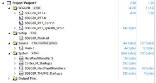

First I created a new Project.
File > New Project > Create the project in a new solution > A C/C++ executable for a Cortex-M processor executing from FLASH memory > "Selecting my part number" nRF52832_xxAA > FINISH.
Then I got the file setup you can see in the picture below.
Now, this project runs the main() fine on my nRF52832 module.

Question1: I see different assembly files than the examples have. As long as the project above builds and runs fine can I add my own C code on top of it?
Initializing clocks, etc...
In the examples (to be exact in peripheral/uart example) I saw 3 different assembly files.
ses_startup_nrf_common.s
ses_startup_nrf51.s
thumb.crt0.s
Question 2: What's the difference between them? Do I have to use them or I can just use the ones the Segger Embedded Studio generated?
