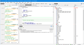

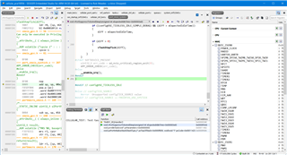

The problem I have is that my build hangs after a few hundred milliseconds. If I change FreeRTOS.h so that it uses SysTick instead of RTC then no such problem occurs.  Disabling configUSE_TICKLESS_IDLE doesn't make things better.  If I run under the debugger and pause it once things have hung it shows that the code has entered the idle task then, for some reason, the SPIM2_SPIS2_SPI2_IRQHandler(), which is not something I've enabled or am using so I guess is an artefact of the debugger, and then done nothing afterwards.
