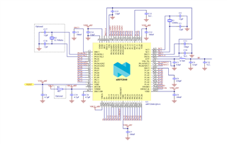

Please have a look and let me know about it.

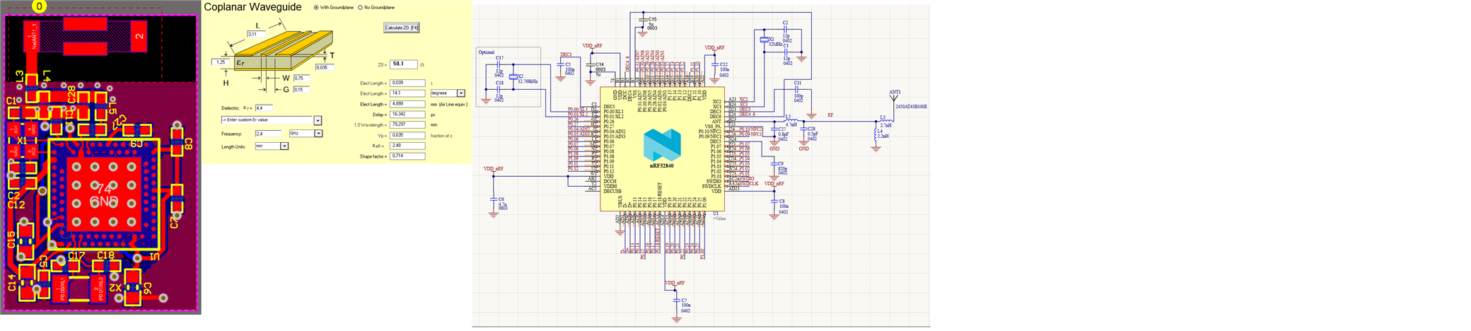

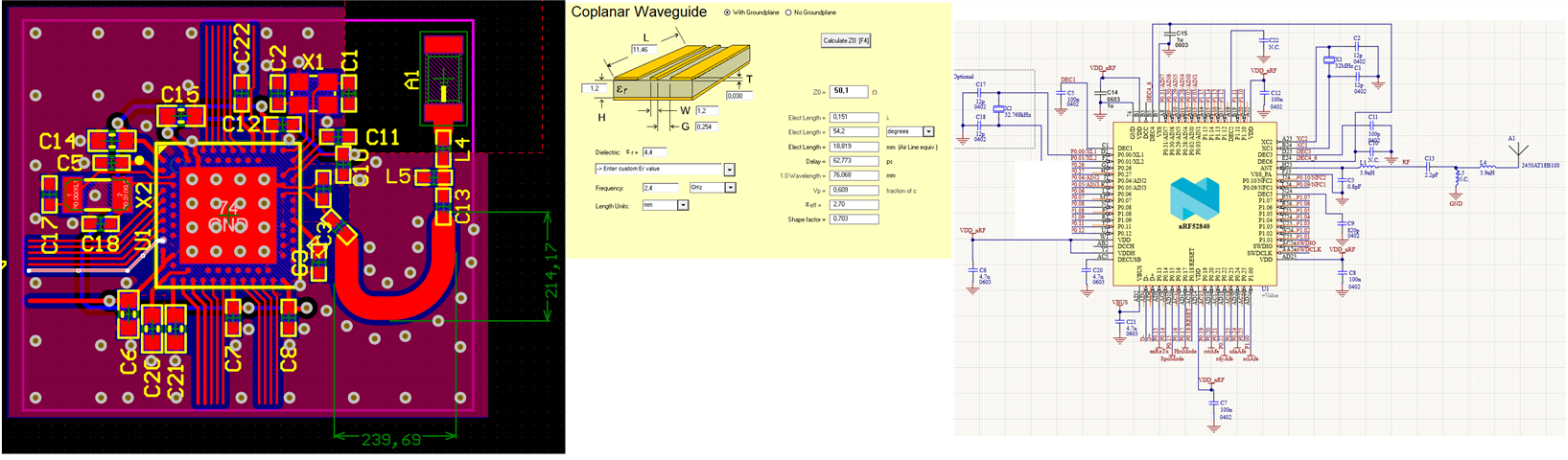

This board is two layers and i used chip antenna. I would like to ask you, Is this design is correct? How can i plan with less antenna area?

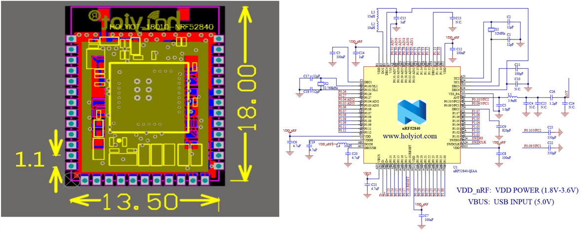

I try YJ-18010-nrf52840 module and worked very well. I could communicate between two boards at 150 meters. I dont understand YJ-18010-nrf52840 module design, I saw an short feed line. Can you explain how it work?
YJ-18010-nrf52840 module link : http://www.holyiot.com/eacp_view.asp?id=278
