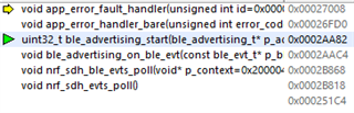

ble_app_uart_pca10040_s132 crashes at app_error_fault_handler with stack trace implying the ram errata [108] RAM: RAM content cannot be trusted upon waking up from System ON Idle or System OFF mode is happening after adding *(volatile uint32_t *)0x40000EE4
I am using an nRF520 PCA10040 dev board with a nRF52832 module and I am trying to get the ble_app_uart_pca10040_s132 FW to run using the SES segger tool set.  After about 1-10 minutes it crashes, and when its run from the debugger its stack trace ends at the app_error handlers void app_error_handler_bare(ret_code_t error_code) and then __WEAK void app_error_fault_handler(uint32_t id, uint32_t pc, uint32_t info).  When I look at the stack trace I see a NULL pointer or one that points to illegal memory which causes a memory fault.  I can see in the function that is calling the function that shows the illegal pointer value that the calling function has a valid location it is trying to pass to the function that gets the corrupted pointer that causes the fault.  I have only seen the issue with call stack traces that start from an interrupt service routine.  I have seen it happen in 3 different ISRs.  I attached one here and saw the UART receive data interrupt happen with the fault and one other case.  The ram errata [108] seems to match the symptom if the interrupts are happening in a way that it wakes up the arm processor.
