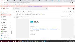

Thank you very much for the reply.
I included the SUPL part into my code, I am trying to get the SUPL client but my application has been disapproved.
Please see the attached email screenshot.
Please let me know what i can do to get my application approve so that i can download the SUPL client.
Thanks and Regards
Samuel.

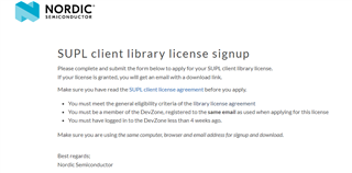

I got the same problem before:
https://devzone.nordicsemi.com/f/nordic-q-a/58976/agps---assisted-gps-thingy91
check again 3 conditions:
Unless you must wait for nordic's engineer.
Goodluck
Hoang is correct, a denial comes when those three conditions are not fulfilled.
I am sure i qualify with all the conditions stated.
Could you kindly check my devzone account, so i know where exactly i fall short.
Thanks
