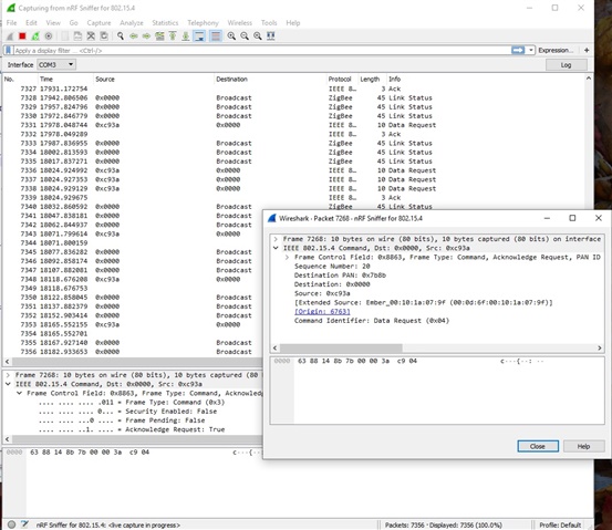

Hi, Im developing a Zigbee concentrator. I used nRF5_SDK_for_Thread_and_Zigbee_v3.1.0_c7c4730 ble_zigbee_template as start point of my project.
The light bulbs and switch control is working well, the first sample are on the field for test:
Now I'm approching to IAS zone sensors.
My question: how can I check if sensor is connected and working?
I see on the sniffer that battery device sends timed requests (see image above). Can I intercept with a callback this communications?
Many thanks for answer
