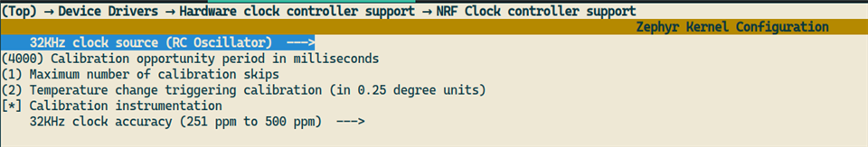

I have a Nordic 52810/PCA10040 DEV board with the latest zephyr.
In Zephyr configuration I using hardware clock option -> 32KHz clock source (RC oscillator)
I expect zephyr using the external 32MHz oscillator (HFXO) as source of the HFCLK

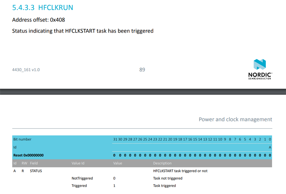

According to the Nordic spec, we check two registers below.
Seems the value isn't as expected.
Please correct me if I'm wrong.
*nrfjprog --memrd 0x40000408
[Expected value]
0x00000001
[Actual value]
0x00000000
*nrfjprog --memrd 0x4000040C
[Expected value]
0x00010001
[Actual value]
0x00010000

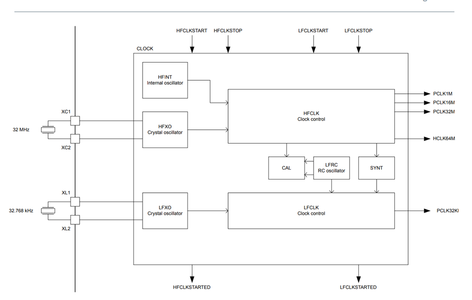

    SeanKao said:
    thanks, is there anything I can do to force the HFCLK to work with external 32M crystal? So that I can verify the external 32M crystal is working as expected.
    You can run this sequence, and if you hang in the while-loop, the hardware has issues with starting up the external HFCLK:
    NRF_CLOCK->TASKS_HFCLKSTART = 1;
    while (NRF_CLOCK->EVENTS_HFCLKSTARTED == 0);
    NRF_CLOCK->EVENTS_HFCLKSTARTED = 0;
    Note that this might be overridden by other modules if they also control the HFCLK directly.
    Håkon
