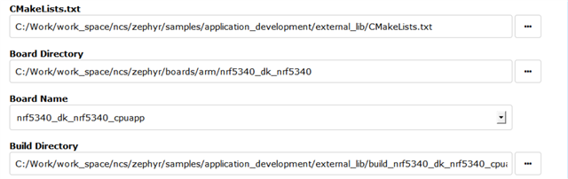

    How did you build the project?
    With west, you could run as:
    C:\ncs\zephyr\samples\application_development\external_lib>west build -b nrf5340_dk_nrf5340_cpuapp
    With Segger, you should set as:
    I can build the project with these two methods. Could you try again?
