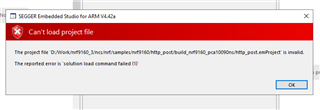

Doing some power testing on the nrf9160 custom board using the MQTT example, I am seeing between 190uA to 200uA of sleep current using a meter.
I disabled serial in both SPM and the mqtt application, included PSM etc. I have seem many places include CONFIG_POWER_OPTIMIZATION=y in the proj.conf file but when I try to add it to my proj.conf , the project fails to load
What can i do to further reduce the idle current down from 190uA? I have seen many people here able to achieve much lower currents.
