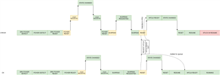

  • Hi Krystian,
    My apologies, I have been out-of-the-office for some days.
    Background of the issue: when RESET event arrives, the HFCLK is requested and HFCLK_READY handler is called right away as the clock is already running.
    When queue is enabled, the HFCLK_READY handler adds an event to the queue and this is handled safely after RESUME event (which changed state from SUSPEND to RESUMING), changing state from RESUMING to ACTIVE.
    On the other hand, if queue is disabled, HFCLK_READY handler is called before RESUME event arrives. This is unhandled state change and later when RESUME event arrives, there is no HFCLK_READY event to change state from RESUMING to ACTIVE.
    R&D has been exploring this issue, and observed that when disabling the event queue in USB stack (setting APP_USBD_CONFIG_EVENT_QUEUE_ENABLE to 0), this causes an ordering issue per how the app_usbd expects things to occur, as shown in the diagram here:
    This is unfortunately a fundamental issue with how app_usbd handles SUSPEND and WUREQ events, and providing a bug fix will take some time. Is it possible for you to use the event queue (APP_USBD_CONFIG_EVENT_QUEUE_ENABLE set to '1') for working around this in your application?
