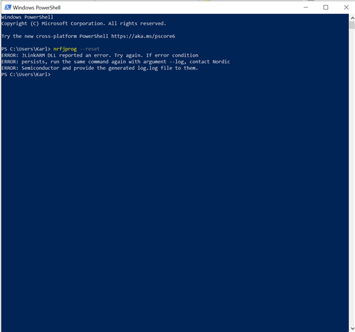

Hi I'm having trouble updating the firmware on a custom board using JTAG through the NRF9160 DK.
I've attached the log file from the programmer of the error I'm getting. I've already checked all possible hardware faults.
When I try to open the device using the drop down menu I get this:
but nothing else happens. If I leave it in this state for a while , then close device, and open again it connects for some reason.
But when I try to erase and write the new hex file I get the errors in the attached log.
Would be very grateful for any help.

    If you use nrfjprog as a command line you will be able to communicate with your attached device
    so
    nrfjprog -e will erase the device
    nrfjprog --reset will reset it
    nrfjprog --program merged.hex will program the thing
  • Thanks for the reply John, unfortunately that didn't do the trick for me. I get this error:
    log.log file attached.
    2451.log.log
  • Hmmm, I was advised to downgrade jlink to version 6.54 or lower as there is a problem with serial connection.
    So after using nrfjprog as a programming method and subsequently downgrading to jlink 6.54 for another reason I hadn't checked using the programmer again.
    So it works now, indicating that it may have been a jlink problem.
    Use the following link and select 6.54 as the version.
    https://www.segger.com/downloads/jlink/#J-LinkSoftwareAndDocumentationPack
