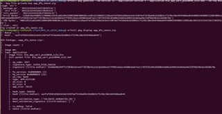

I found the file in the SDK folder. I am trying to generate nonce as in the example mentioned. https://devzone.nordicsemi.com/f/nordic-q-a/37260/adding-encryption-to-secure-dfu-sdk-v15
Before I added nonce the data-packet size was 141 bytes, and even after making changes the size of the dat file has not changed.
Can you tell me if the example mentioned in the link is how it has to be done?
Please see the picture above for reference. The nonce is "3031323334...", which is not visible in the write bytes packet or command packet.
Hi Navin
Did you remember to edit the dfu-cc.proto file and regenerated the dfu_cc_pb2.py file with the protocol buffer compiler as that is recommended in the comments of the blog post you're using.
Simon
Hello Simonr,
I had made a mistake while editing the init_pcaket.py file. Sorry for that! I am now able to generate pb.h and pb.c files on both the PC, as well as for the microcontroller using nanopb.
