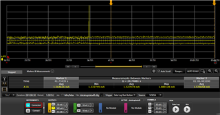

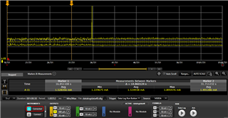

We tested the idle feature(by AT#XSLEEP=0)  on nRF9160DK, but no significant change of power consumption before and after enter into IDLE mode, is this result correct or performed as expected? Could you share your result?
avg current before enter into idle: 1.535mA
avg current after enter into idle: 1.527mA
PS: the pulse is the input AT command AT#XSLEEP=0
