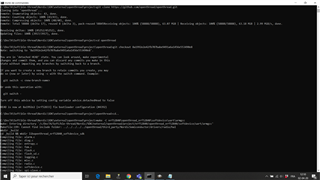

    I'm sorry but I have an issue with the point number 4. When I enter the command "make -C nrf52840\openthread_nrf52840\softdevice\uart\armgcc" I have this response:
    But I notice that there are a difference in the GNU version (the mine is "C:\Program Files (x86)\GNU Tools Arm Embedded\9 2019-q4-major")
    How can I change this script ?
    Thank you

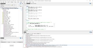

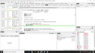

  • Here are the results:

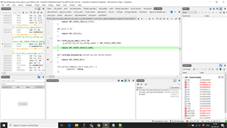

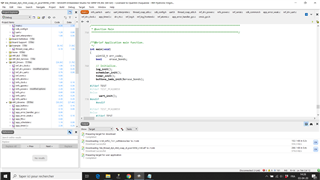

    But I have this error when I compile :

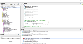

    So I added "UART1_ENABLED=1" in preprocessor definitions of my projet and I've had this error:
  • The error seems to come from the file you should remove in step 5. Did you remove it and add the newly built file?
