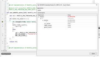

  • Thanks for your reply, I have posted the track when called the user_mbedtls_mutex_lock above, please have a look on the original posted. I update the SDK to 16.0 today and ran the program again, it didn't crash when called user_mbedtls_mutex_lock, but it got stuck forever, and this link didn't help as well, do you know what would be the possible problem?
  • can you keep a count on calls to xSemaphoreGive and xSemaphoreTake to see if the semaphore is given enough times for this mutex to be unlocked? What I mean to say is, could it be possible that the application is not unlocking the mutex properly?
  • I add two variable to the struct mbedtls_threading_mutex_t  for counting the take/give mutex control and update the mute_take/mutex_give function, please see the following snippet code

    the take and give mutex count is 0, so I think it would be successful to take the mutex, BUT the program would stuck at the if statement "if( xSemaphoreTake( mutex->mutex, portMAX_DELAY ) ) " forever.
