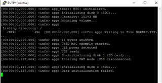

Hello Nordic Support,
I am working on an application that can write to SD card when disconnected from USB and appears as USB Mass Storage Class on host PC when connected to USB.
I have referred to the suggestion given here: https://devzone.nordicsemi.com/f/nordic-q-a/57873/how-to-enable-and-disable-usb-connection-when-using-nrf52840-dk/241140#241140 and was able to make the SD card appear as USB Mass Storage Class on the host PC and make it disappear on a button press and make it appear again on pressing the button again.
However, writing to SD card works only once, i.e during the program start up. When the USB is disabled by button press, writing to SD card fails because fatfs initialization fails.
Here is the program that I am using:

#if USE_SD_CARD
static bool fatfs_init()
  static FATFS fs;
  static DIR dir;
  static FILINFO fno;
  FRESULT ff_result;
  DSTATUS disk_state = STA_NOINIT;
    // Initialize FATFS disk I/O interface by providing the block device.
    static diskio_blkdev_t drives[] =
            DISKIO_BLOCKDEV_CONFIG(NRF_BLOCKDEV_BASE_ADDR(m_block_dev_sdc, block_dev), NULL)
    diskio_blockdev_register(drives, ARRAY_SIZE(drives));
    NRF_LOG_INFO("Initializing disk 0 (SDC)...");
    for (uint32_t retries = 3; retries && disk_state; --retries)
        disk_state = disk_initialize(0);
    if (disk_state)
        NRF_LOG_INFO("Disk initialization failed.");
        return false;
    uint32_t blocks_per_mb = (1024uL * 1024uL) / m_block_dev_sdc.block_dev.p_ops->geometry(&m_block_dev_sdc.block_dev)->blk_size;
    uint32_t capacity = m_block_dev_sdc.block_dev.p_ops->geometry(&m_block_dev_sdc.block_dev)->blk_count / blocks_per_mb;
    NRF_LOG_INFO("Capacity: %d MB", capacity);
    NRF_LOG_INFO("Mounting volume...");
    ff_result = f_mount(&fs, "", 1);
    if (ff_result)
        NRF_LOG_INFO("Mount failed.");
        return false;
    NRF_LOG_INFO("\r\n Listing directory: /");
    ff_result = f_opendir(&dir, "/");
    if (ff_result)
        NRF_LOG_INFO("Directory listing failed!");
        return false;
    do
        ff_result = f_readdir(&dir, &fno);
        if (ff_result != FR_OK)
            NRF_LOG_INFO("Directory read failed.");
            return false;
        if (fno.fname[0])
            if (fno.fattrib & AM_DIR)
                NRF_LOG_RAW_INFO("   <DIR>   %s",(uint32_t)fno.fname);
            else
                NRF_LOG_RAW_INFO("%9lu  %s", fno.fsize, (uint32_t)fno.fname);
    while (fno.fname[0]);
    NRF_LOG_RAW_INFO("");
    return true;
static void fatfs_file_create()
    static FIL file;
    FRESULT ff_result;
    uint32_t bytes_written;
    NRF_LOG_INFO("Writing to file " FILE_NAME "...");
    ff_result = f_open(&file, FILE_NAME, FA_READ | FA_WRITE | FA_OPEN_APPEND);
        NRF_LOG_INFO("Unable to open or create file: " FILE_NAME ".");
        return;
    ff_result = f_write(&file, TEST_STRING, sizeof(TEST_STRING) - 1, (UINT *) &bytes_written);
        NRF_LOG_INFO("Write failed\r\n.");
    else
        NRF_LOG_INFO("%d bytes written.", bytes_written);
    (void) f_close(&file);
    return;
static void fatfs_uninit(void)
    DSTATUS disk_state=disk_status(0);
    NRF_LOG_INFO("Un-initializing disk 0 (SD card)...");
   disk_state = disk_uninitialize(0);
 * @brief Class specific event handler.

Output that I get:
