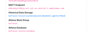

Hi there,
I was wondering how the motion pane is supposed to work in the bifravst app, it doesn't seem to be refreshing. The battery pane doesn't seem to be refreshing either..

The Motion shows the last "acc" message sent from the device, and the battery pane shows the last incoming "bat" messages. They are queried using Athena, so you can check what's in your S3 historical data bucket, to see which messages arrived.
If they are not refreshing, this means most likely that the device is not sending in updates, or that they are not stored in your S3 bucket, you can find the link to the S3 bucket on the About page of the app.
