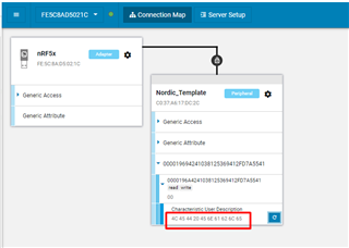

Characteristic User Description - Name appears in hex format
Hi everyone,
I have added the Characteristic User Description in order to add a human-readable name for my characteristics. However, the name still appears in hex format at nRF connect
This is the code snippet related to the Characteristic User Description
 static char *user_desc_text = "LED Enable";
 memset(&add_char_user_desc, 0, sizeof(add_char_user_desc));
  add_char_user_desc.max_size = strlen(user_desc_text);
  add_char_user_desc.size = strlen(user_desc_text);
  add_char_user_desc.p_char_user_desc = (uint8_t *)user_desc_text;
  add_char_user_desc.is_var_len = false;
  add_char_user_desc.read_access = SEC_OPEN;
  add_char_user_desc.write_access = SEC_NO_ACCESS;
Any advice?
Thanks in advance
Nick
