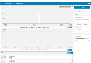

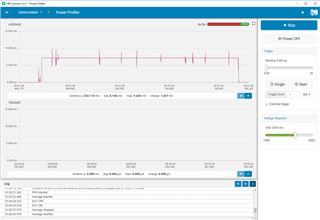

It is hard to estimate the power consumption...
What is the power consumption of the receiver doing partial scanning with window of 200msec every 2 min?
