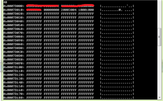

   I had got some problem with fds_record_write(). I found that I couldn't get the correct data from flash without waiting fds_evt_handler( ) that was called after calling fds_record_write( ).
This is the wrong data below.

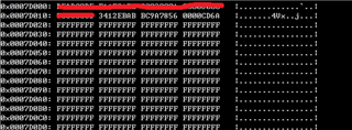

So I change my code.I had waited  fds_evt_handler( )  that was called after calling fds_record_write( ).And I got the correct data.There is below.
And there is my code with waitting  fds_evt_handler( ). It must wait for the fds_evt_handler( ) after calling fds_record_write( )?

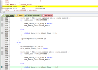

Unfortunately, My code was stuck at while( data_write_flash_flag !=0 ). And then  I check the assembler, I found the " while( data_write_flash_flag !=0 ) " was compiled to CMP r0, #0x00. It compared to zero ,so my code was stuck at here.I have no idea for that. please tell me what do I miss.

    james said:
    And what abuout "It must wait for the fds_evt_handler( ) after calling fds_record_write( )?"
    I don't know if this is still a question, but if so, the answer is that all FDS operations are asynchronous. So the writer will take some time to complete, and therefore you need to wait for the FDS event indicating that it has completed. That does not mean that you cannot do other things, but the write buffer needs to stay valid, and you cannot read it etc. before it has actually been written.
