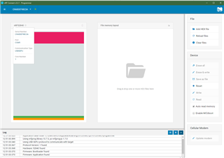

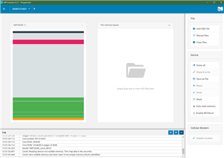

Below are what nRF connect programmer shows when I select the dongle in bootloader mode or select the j-link. The j-link image looks quite strange too me.
