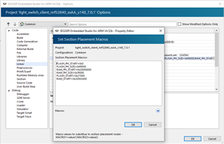

I want to create a mesh network with two nrf52840 dongles. To programming them I used the light-switch example from SDK Mesh v4.0.0 following the steps in this tutorial: devzone.nordicsemi.com/.../nrf52840-dongle-programming-tutorial. When I tried to provisioning them with nRF Mesh app for Android I didn't see them. Can you tell me what changes I have to make in the code?

    1) I did:
    - took the project: nrf5_SDK_for_Mesh_v4.0.0_src\examples\light_switch\client\light_switch_client_nrf52840_xxAA_s140_7_0_1
    - changed the settings of preprocessor definitions in board-type from PCA10056 -> PCA10059
    - changed the settings of Preprocessor -> Linker -> placementMacros ... addresses like in attached screenshots
    addresses_DKaddresses_Dongle
    - then I changed in the main() to have RGB led on immediately after initialize

    - then downloaded the hex file using nRF-connect-Programmer.
    - then nothing happens when starting the dongle
