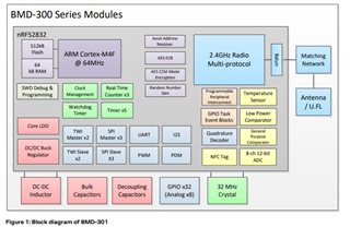

But, the same firmware i have uploaded in my custom designed board which has BMD301 chip.All other example like ble_app_bms example works with below configuration.
Does external crystal required in BMD301 circuit for secure_bootloader ? Currently we haven't connected any external crystal. You can see in schematics below.
I want to add DFU in my application firmware.So,
Please suggest me configuration for secure_bootloader  in sdk_config.h If I am missing something else which is specific to BMD301, Please mention.
Here is schematics of my board,
Here is clock setting in sdk_config.h
