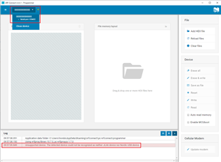

At first, I just insert the USB dongle to the PC's USB. The PC can recognize the USB (Image 1) but nrf Connect for Desktop application (latest version, i.e. nRF Connect v3.3.1, Programmer v1.4.1) said the device does not support (Image 2), tested on both Mac OS and Windows.

Afterward I found these blog pages:
raytaccorp.blogspot.com/.../burn-your-firmware-onto-mdbt50q-rx-that.html
raytaccorp.blogspot.com/.../firmware-coding-dfu-onto-mdbt50q-rx.html

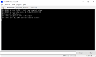

So I tried to wired with J-Link, I am able to burn my firmware either through SEGGER Embedded Studio > Target > Download ble_app_uart_c_pca10056_s140 or nrf Connect for Desktop. Just like other devices I previously used.
(Image 3, Sample of the dongle connected with J-Link RTT Viewer can view the NRF_LOG properly)
(Image 3)

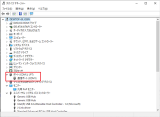

However after burned and insert the dongle to PC, the COM port does not appear (Image 4).
(Image 4)
Am I missing something like incorrect setting?

  • Hi Joe
    Can you confirm which SDK example you are basing your project on?
    The ble_app_uart example does not configure the USB interface, and if you flash this firmware into your dongle it will not enumerate as a USB device.
    The usbd_ble_uart example combines the USBD CDC example (virtual comport) with the ble_app_uart, and should work on the dongle: \nRF5_SDK_16.0.0\examples\peripheral\usbd_ble_uart example

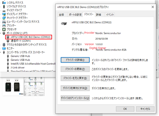

  • Hi Torbjørn
    Thank you for your reply.
    I am using SDK 16.0.0.
    I have tried your suggested example "usbd_ble_uart" and my PC (windows) can detect the USB dongle as a COM port device (COM24).
