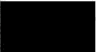

However, I have problem on opposite part: receiving data from central to PC.
When I turn on PUTTY, received data are shown like this. I don't know how to fix it.
Data format from peripheral device to central: uint8_t array, with size of 243: Peripheral is nrf52832, and it sends ADC data.
I checked that peripheral device works well (checked through nrf connect app)

  • I do not see anything wrong in your data handling on the central side. The snapshot of putty seems to be the difference in baudrate in which you opened putty and the baudrate with which the nRF52 is operating. Make sure that your PUTTY configuration are similar to the setting you used for UART peripheral in the nRF52 to which the PUTTY is connected to.
  • Ah, I'm using usbd, not UART. So baudrate doesn't matter..
    In my opinion, this happens because of data format.
    From the original example, I remember that nRF52840 receives data array in char format.
    But here, I changed it to uint8_t, because my peripheral device sends the data in that form.
    So while doing memcpy from uint8_t to char m_nus_data_array, computer cannot understand the data I think, maybe in the process of ASCII? I don't know...
    What do you think? Do you have any idea or suggestions?
    Thanks for reply.
  • looking at your terminal output, it seems that one character is logged a lot of times, so I would assume that this is not a formatting issue. In anycase, you can try to change your uint8_t back to char and see if you see any difference.
