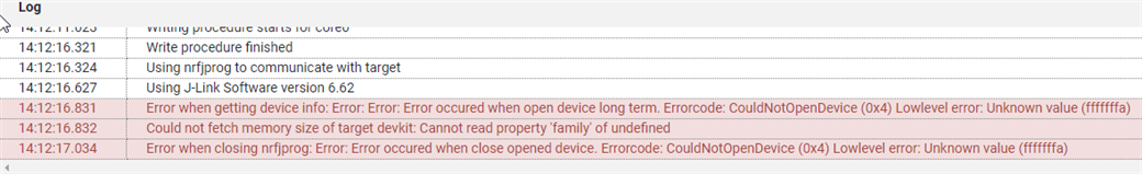

Hello:
    I am using nRF Connect v3.3.1 programmer to flash nRF9160 and got an error.
    Silk on nRF9160 is: nRF9160 SICA B0 191601
    Programmer can't recognize nRF9160 after error.
    I tried nrfjprog -e to erase but failed:
    I tried older nrfjprog and successed to erase the nRF9160:
    So is there a bug on nRFjprog_10_7_0?

    I used only one nRF9160DK to flash my nRF9160.
    Can you please try to flash GPS.hex with Programmer? My Programmer version is v1.4.1
    Issue will 100% happen when I flash GPS.hex with programmer v1.4.1

  • I was able to reproduce the issue on my computer. Using the programmer app and the hex file you provided, the issue presented itself here as well. Trying to erase device with nrfjprog in the command line gave me the same error as you described.
    I was able to fix the issue with doing nrfjprog -f nrf91 -e, and updating the nrf connect for desktop app to 3.3.2. This will install latest Jlink driver 6.70.
