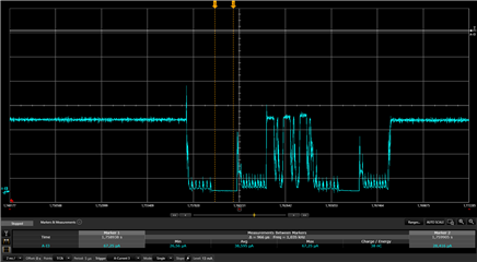

Issue is that this change increased power idle consumption from 50μa to 550μa.
Is there any way to increase external peripherals supply voltage without increase of idle consumption?

  • Felixx said:
    Yes, it's expected consumption. Interesting why sometimes it goes up to ~500µA and if there is a way how to eliminate this behavior?
     Are any other devices attached to these dongles?
    What instrument do you use to measure the current?
    Felixx said:
    If ESD is the case, is there potential Software fix or should we play with additional elements like capacitors?
     No fix in SW, the only HW fixes are ESD diodes. The nRF devices have two ESD diodes on GPIO, but they are there to protect the rest of the circuit, they will burn if sufficient voltage/current is applied. Capacitors won't help as they are not cost-effective. The only way to protect your devices is a good layout and regular ESD measures in your workspace.
