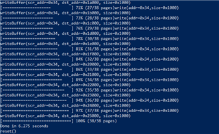

    I am currently flashing over a SAM -BA Bootloader (the one installed on my Arduino nano board) via USB serial.
    I am also running teh blinky example using SDK 15.0.0 with the corresponding Softdevice (6.0.0).
    However, it seems that nothing is happening (no Peripheral detected while scanning BLE).
    I compile the ble_app_blinky with Keil environment (PCA10056 board) and everything is fine concerning linker script (ROM/RAM offset) and I also set up RC internal clock since the Arduino board does not have XTAL.
    So, in a nutshell, I first flash Softdevice with "Bossac" command then perform hex2bin for the blinky app and then flash it again with "Bossac".
    Did u suspect something wrong in my procedure? Is Bossac recommended in that case? Or maybe I am missing something

    Yes, i am talking about the SAM-BA factory bootloader of which I have recently checked the code and I have discovered they do not automate app start adress calculation.
    Consequently I'll load a different bootloader (the Adafruit_nRF52_Bootloader compatibles with nano 33 board) as soon as I'll receive the programming board. Hope will be fine once done.

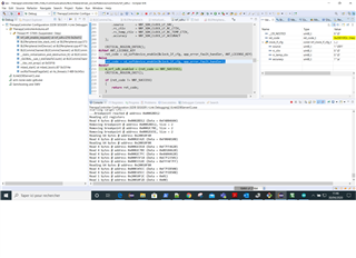

    Does sd_softdevice_enable return a non-zero error code ?
    Best regards
    Bjørn
  • Hi Bjorn,
    Thank you again for your quick response.
    Yes it is a non-zero error code.
    To get deeper in detail, here is the ret_code once the "sd_softdevice_enable" executed:
    More precisely, this code come from a SVC_exit call in the irq_cm4f.S (cmis rtos starup code source:) which handles <SVC_Handler>.

    This is only for examinate this issue, now I will be interested in redirecting the call  to the softdevice SVC_Handler only for SVD call number above 0xF which is my case (0x10 for the softdevice_enable code).
    Maybe should I redirect Supervisor calls back to asoftdevice thanks to the sd_softdevice_vector_table_base_set function?
