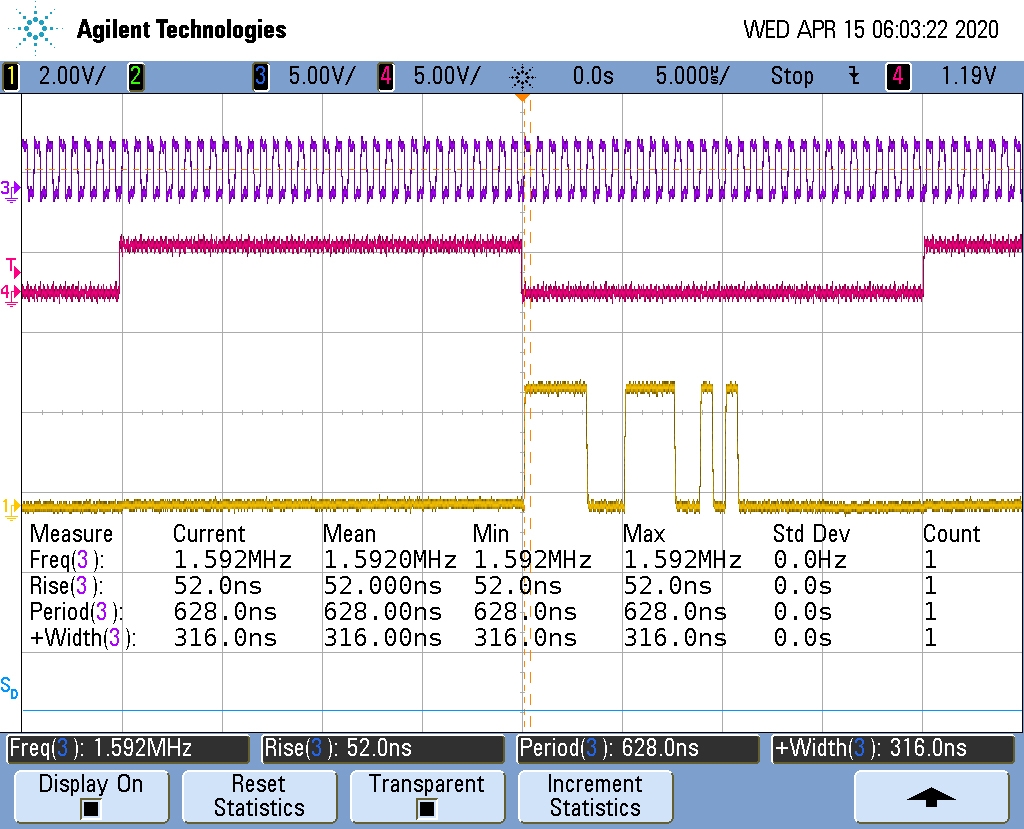

I am trying to get the I2S peripheral working for the first time. The problem could be something very silly. I am using a BMD-350 which is a NRF52832 inside a module and lots of other peripherals are working just fine on a custom board. I am attempting to interface the NRF52 with a SPH0645 which is an I2S mono microphone. It's a 24bit device, needs 32 clocks. I am using 2 PWM outputs to output a roughly 3Mhz signal for the BCLK and a BCLK/64 for the WS signal. Microphone is set to only output with SEL grounded. I am looking at the signals on an oscope and I see a BCLK, a WS, and the data out from the microphone in perfect I2S. Everything on the wire looks excellent. I have also verified solder connection by sending my PWM signal out the SDIN line temporarily and it wiggles. Therefore, the physical path into the NRF52 seems to be working.
What doesn't seem to be working is getting any data read back. The handler interrupt gets called once at the very beginning, and it never gets called again. Both of the 2 buffers are completely empty, all zeros. The interrupt never fires again. I see data moving on the scope.

Channel 3 (top) - BCLK out from NRF52 into SPH
Channel 4 (middle) - WS out from NRF52 into SPH
Channel 1 (bottom) - DATA out from SPH into NRF52
