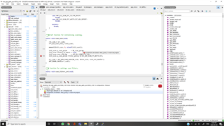

  • Hi Simon ,
    I tired compiling with your changes and it throw me an error reporting the filter_policy is just read only. I have attached the screen post along with this message.

  • Try to add it in the following manner instead:
    static ble_gap_scan_params_t m_scan_param =                               /**< Scan parameters requested for scanning and connection. */
        // Other params
        .filter_policy = BLE_GAP_SCAN_FP_WHITELIST,
        // Other params
    /**@brief Function to start scanning. */
    static void scan_start(void)
        ret_code_t ret;
        ret = nrf_ble_scan_params_set(&m_scan, &m_scan_param);
    static void scan_init(void)
        init_scan.p_scan_param     = &m_scan_param;
    Simon
