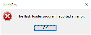

I am developing for an nRF52810 target application.
I am using IAR 8.42 with a PE Micro debugger.  If I debug a project (call it project A), the linker ROM space starts at 0x0, I can program a device with the debugger, and run and step through the code.
If I create a project (project B) that loads S112 at offset 0 and the linker ROM space starts at 0x190000, I can run the code.
However, if I then want to go back and load a different project at 0, and restart the debugging session, the flash loader fails, and I can’t recover my board.  I try to erase the device, but it doesn’t completely erase.  The addresses from 0x0 to 0xAFF do not return to 0xFF.
I have burned through a few boards now.
THe, if I try to start the ROM space at 0x190000, the stack pointer does not align, and I can’t run the code.
Any idea of what is happening?  Thanks
