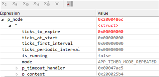

Basically, I am trying to debug a possible memory corruption issue. I know what area of memory is getting corrupted. I know what code should be accessing that data. Basically I want to set a data write breakpoint which is only enabled if PC is not the expected address range. SES allows me to define a data access expression like this:
“(char[480])0x2000486c && @pc > 0x47953”
But the PC check is ignored. Is this possible? It seems like a common requirement.
Thank again for any help you could provide.
Allen
Hello Axel,
As far as I can tell, this feature isn’t working as expected. Below are screenshoots of the breakpoint definition, local variables, registers and disassembly. The issues I see are:
  1. The cast to treat the address as an array of 480 bytes is not working. The breakpoint only triggers when the local variable p_node matches the expression. This is a 2 dimensional byte array [15][32]. The other array locations do not trigger the break.
  2. The @pc portion of the expression is ignored. Both PC and LR are less than 0x4c600

We are currently suspecting that the type of data breakpoints in the device you’re using is limited (Data Ranges and PC> not possible).
