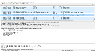

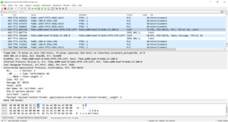

I would like to detect timeout when I send a confirmable coap message not received.
My problem is that the response I receive in my response_handler is always "OT_ERROR_RESPONSE_TIMEOUT" even if I receive the ack with the correct token and the correct message ID (I see it with Wireshark).
Do you see an error in what I did?
