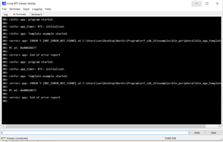

1. my understanding of this function "ble_advertising_conn_cfg_tag_set(&m_advertising, APP_BLE_CONN_CFG_TAG);" is just a tag created for a particular advertisement configuration, and unique tag ID can be created for multiple configuration. The problem is, if i dont use this function, my app runs into some kind of run time error, which i can see it in RTT viewer, please find the below screenshot from the RTT viewer. But ideally even without the function the program should work fine, shouldnt it?
    Ans. ble_advertising_conn_cfg_tag_set() is the function for changing the connection settings tag that will be used for upcoming connections. Please see the note in the Bluetooth low energy examples:
    When setting connection-specific configurations using sd_ble_cfg_set, you must create a tag for each configuration. This tag must be supplied when calling sd_ble_gap_adv_start() and sd_ble_gap_connect(). If your application uses the Advertising Module, you must call ble_advertising_conn_cfg_tag_set before starting advertising.
