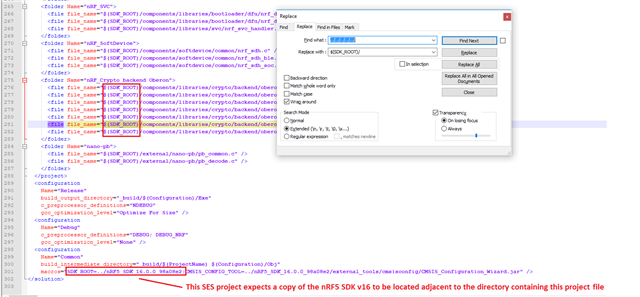

    Also, if you wish to move the project outside the SDK folder structure, you can do that quite easily by opening the emProject file in a text editor and replace the relative paths with a custom variable as shown below.

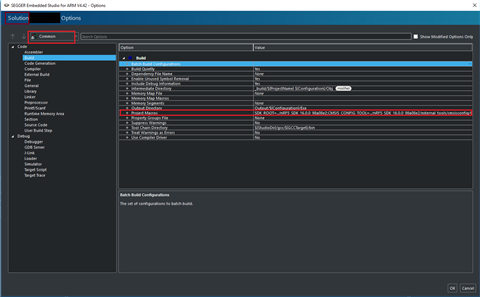

    The SDK_ROOT variable can be added and changed under 'Solution' settings in SES (make sure it's applied to the common configuration)
