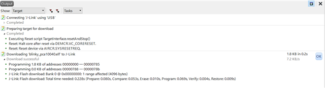

But when I upload the code to my board, nothing happens.
Here is the output of SES:

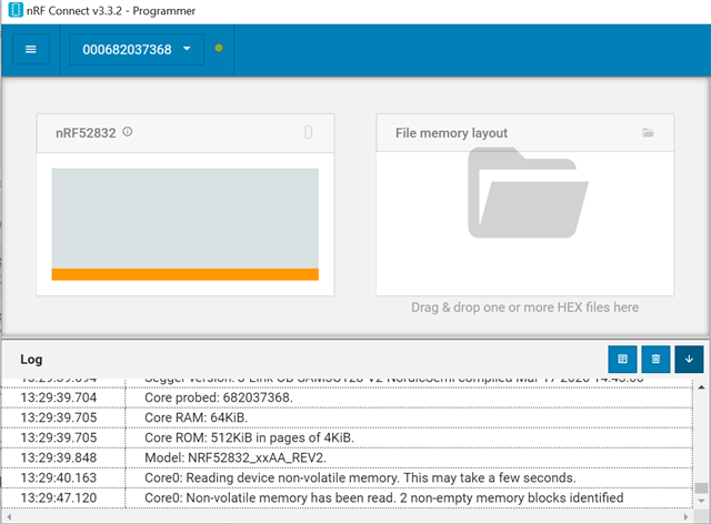

Here, what appear on nRFgo after loading the project:
And before loading the program was like this:

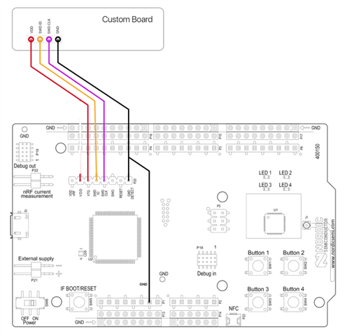

    Can you show me how your board custom board is connected to the NRF52DK debugger? Please use the picture below as reference when connecting your custom board to a DK's debugger.
    I am using this configuration, except that i am not shorting VDD and VTG, I am just using VTG. Couse, i am using external supply for my board, and i read that shorting it will make the DK power my board, but with 5V, and i need 3.3V.
